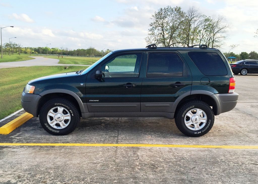

So I finally did some suspension work. A month ago I had a rear shock's upper bolt rust in half. So after some thumping around and realizing it wasn't even attached, just nestled in the pocket, I replaced the rear two shocks with OEM Motorcraft ones. However, for the front I wanted to do a little more.
This last weekend, I had H&R's 1" lift springs installed along with KYB's GR-2 (Excel-G) struts installed including the additional required hardware and even some new Wagner brake hoses.
Here are some quick pictures of the results. I'll take better ones soon... but these were iPhone quick ones in case anyone wanted to see how crazy of a difference it visually makes to the car's appearance (It doesn't). I also need to take a few of the springs and the articulation.
As far as performance goes, it DOES feel stiffer as it should. It's my wife's car so I haven't driven it much this week but It does seem to have less nose dive and squat under hard braking and from digs.
Ground clearance measures ~9.5-inches to the bottom of the "recall-added" front cross member brace.
Along with other pics, I'll show some more measurements soon.
If you have any questions, let me know. I'll keep y'all up to date if anything changes or I have any issues.

It handles well, noticeably stiffer but that could be also that old suspension was... old.
Looks wise, there is not a huge difference. However, I've also learned that Escapes with the trim around the wheel wells, the fender flares, do not look as high as those without it. I sort-of wish mine did not have that option even though it is a "up-grade."
All in all, I'm quite content with the results. I don't feel like I've compromised any of the suspension's integrity, geometry, or life which is number one to me.
I wouldn't have changed what I had installed in any way. Now that I'm running larger than OEM tires, and taller springs (along with other replaced maintenance items), I feel I'm slowly upgrading the Escape to a better than new form. It definitely looks more as it should when parked next to Xterras and other "adventure" SUVs.

Postby Krohn - April 15th, 2016, 2:41 am
A few more...

Postby Squirrel - April 15th, 2016, 8:09 am
Wow! :thumb: Looks better now! MUCH taller!

Thanks! I have noticed that since the install, the rear end creaks more as the body twists over uneven pavement. I'm guessing that's due to increased force from the springs.
I now see why people buy the front strut tower brace, the car does need more bracing.
