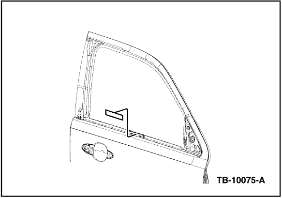

1. Remove affected front exterior door glass weatherstrip. Reference Workshop Manual (WSM), Section 501-11 Glass, Frames, and Mechanisms - Exploded View.
2. Apply a strip of 3M‘Safety-Walk‘ Slip-Resistant General Purpose Tapes, or similar (obtained locally) to the outer flange surface at the center of the door. Cut grip tape to approximately 2.5" X .5" (64 mm X 13 mm).
(Figure 1)
Figure 1 - Article 10-25-4
3. Install new revised exterior door glass weatherstrip. Reference WSM, Section 501-11 Glass, Frames, and Mechanisms - Exploded View.
